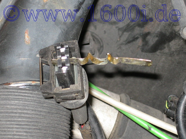

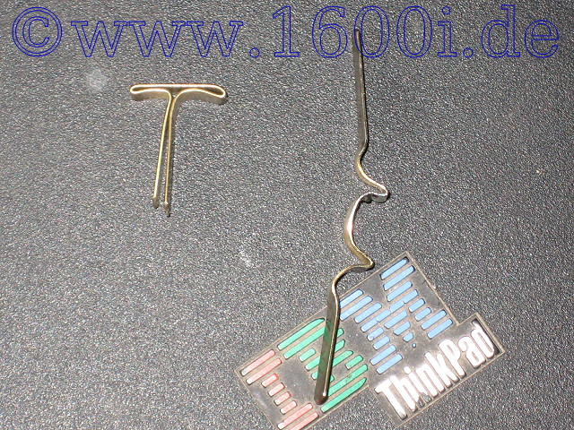

Remove the ignition lead from the centre of the distributor cap and turn it left to the cooler housing. Take care that the distance between the connector for the ignition lead and the cooler housing is about 5 mm. Unplug the flat contact housing of the hall sensor and insert the bent off paper clip in the middle position. Turn on ignition. Make short times contact with the paper clip to metall clip at the distributor cap (ground). Everytime when you contact ground you should see a flash at the connector for the ignition lead and hear the fuel pump running.
Attetion: With this action you may get faults in the memory of the ECU. So you should be able to clear them.
Flachkopfklammer/Verschlußklammer
